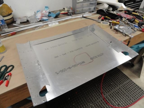

Flush riveted upper 2 cowling stiffeners; Decided to rebuild the sheet metal over the fuel tank because it was a bit flimsy at .025. Since I have lots of .032, I thought I would make the improvement. So, using the .025 panel, I layed out, cut and drilled to match.
