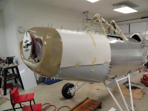

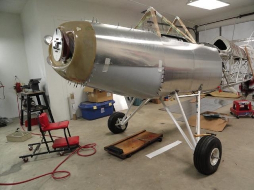

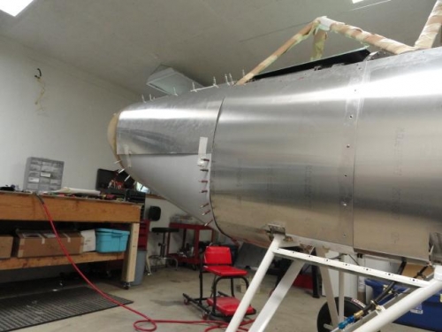

Brief Description:  Engine Cowling
Layed out left hand cowling door with construction paper, then .032 aluminum, but quickly found that that thickness is too stiff. So, using some .025 aluminum, I layed out, cut, and attached the left cowl door. Layed out and drilled holes for attachment to hinge line.
