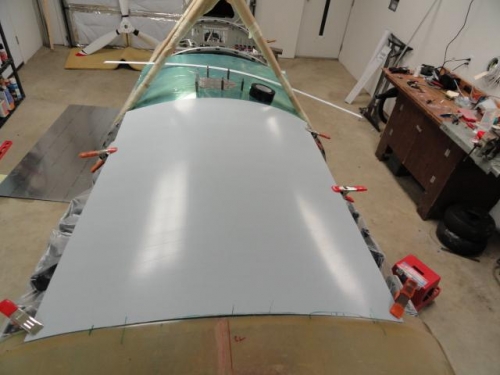

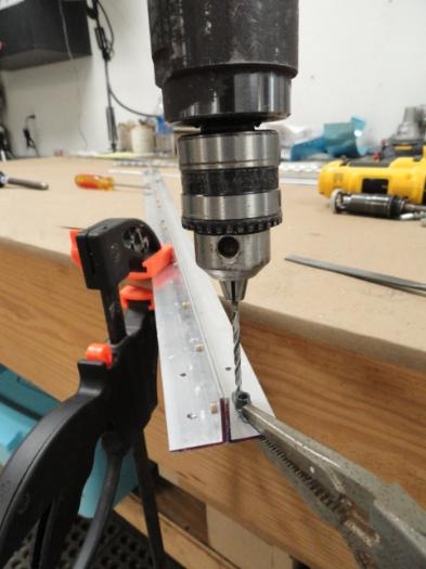

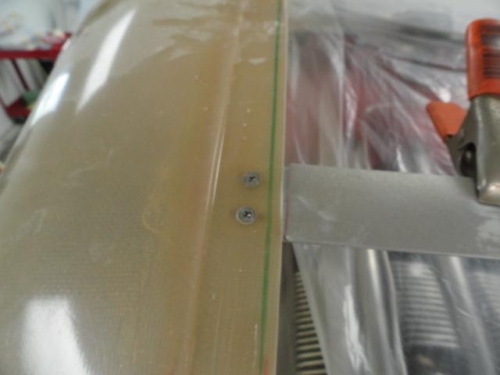

Installed nut plates ( 8-32 floating) on all stiffeners; Layed out pattern for top cowling and then cut .032 sheet aluminum. Started fitting.
