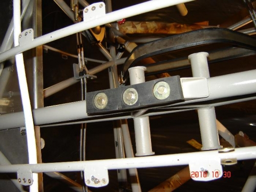

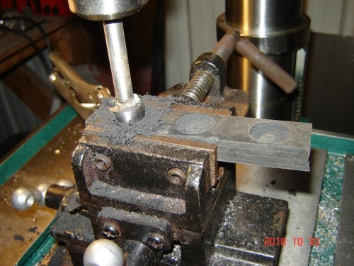

Using some 1/2" 60A Neoprene, I cut out a strip 1 inch wide and 5.5 inches long. I then drilled pilot holes through the rubber and through the gear stop; Using a forsener bit I counter bored a 1 inch to accept a washer and a AN-3 bolt. Installed using fiber nuts which was a trick even with long hemostats.

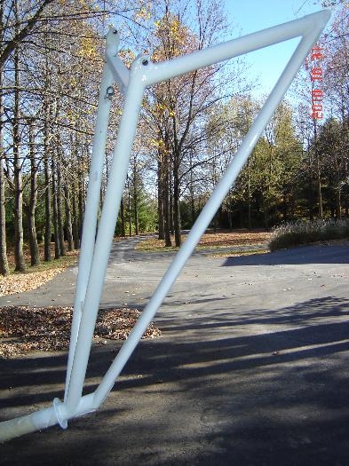

I prepared and painted with Aerothan White Insignia the gear legs that will not be covered.
