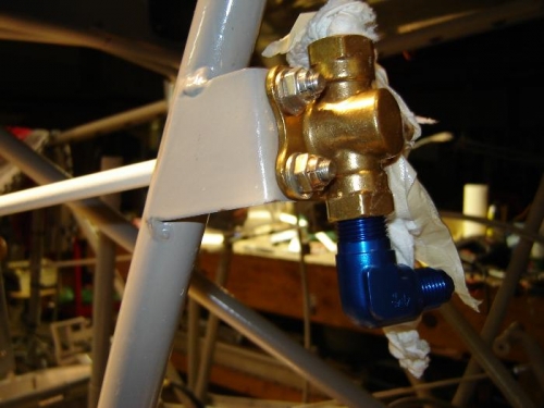

Fuel Valve
Drilled holes 90 degrees apart to accept drive pins. Installed drive pins; prepared and painted fuel valve control rod; installed SS lock wire through pins for safety.Installed fuel valve.
