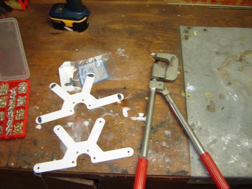

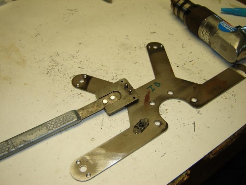

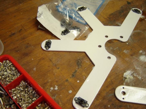

Counter sunk for nut plates. Installed nut plates and put in while epoxy. Finsh sand with 400 wet emery paper the wheel pants. Now ready for paint; test fit with screws for fit.
