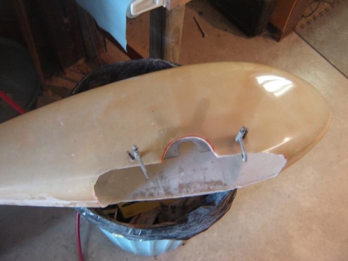

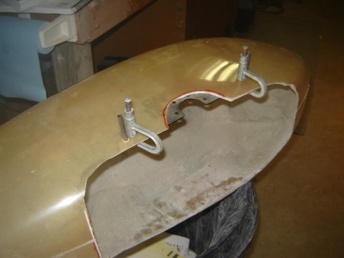

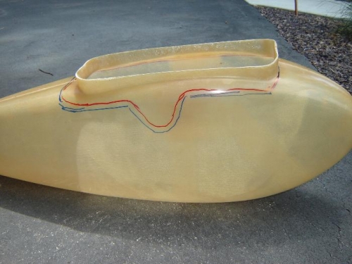

Brief Description:  Wheel Pants
Initial layouts and cuts to wheel pants. Pants are from Steen and are in need of much fitting. I made the initial rough cuts with a electric angle grinder. Once I had the rough opening cut out, I then made sure that the fit over the tire was adequate. Then, I installed spider attach plate and drilled holes by using a small flashlight to illuminate the holes.
