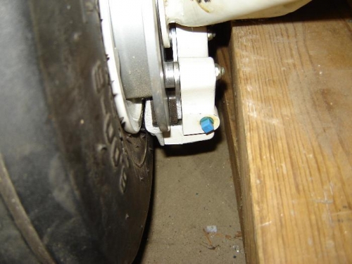

Brief Description:  Brake Set up

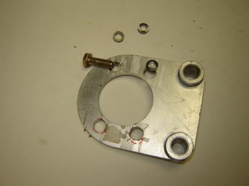

Started setting up brakes. Ran into the problem that the slider plate was drilled to 3/8, but the attach disk on the gear leg was drilled to 1/4 and I think that drilling it to 3/8 would not work well. So, I made some bushings from 3/8 x..063 4130 tubing.
Completed Bushings
Completed Bushings
