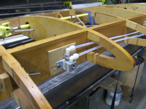

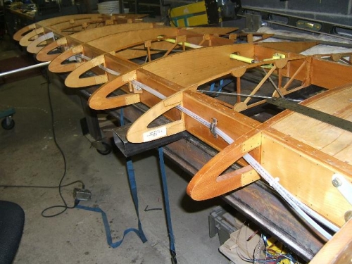

Started to install the formed leading edges onto the wings. Started with the center section, installing the coated nails every 1". I also filed around the butt ribs to smooth the corner for fabric covering.The pitot and static system was installed. I'm using a Pitts style fitting that I made and am running the tubing through the opening in the leading edges.

RH Lower Wing Pitot  System
Running Tubing
Running Tubing
