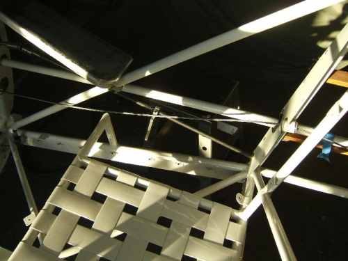

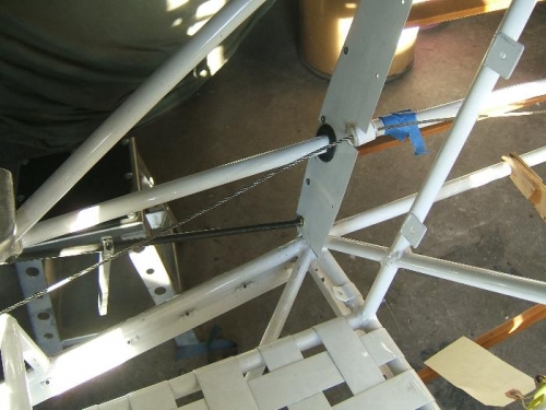

Finished the fuel selector valve. Installed an SS universal joint to direct the on-off ever to a mor comfortable area. The lever/handle needs to be machined down to look better and for weight. The aft end of the rod is located by a -4 bolt seated into the end of the rod. A nice neat detail.
SS universal joint
SS universal joint
-4 bolt locating rod
Location of Lever
Location of Lever
