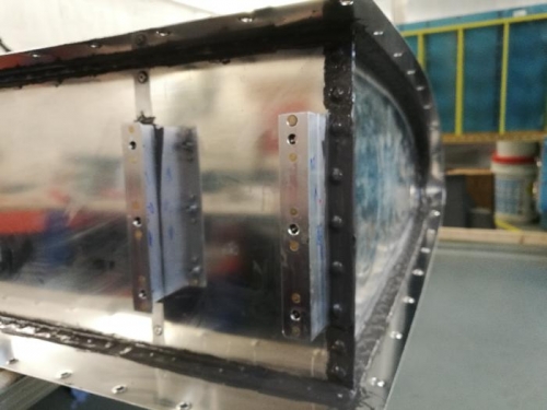

Manual Reference:  LH Fuel Tank.
Brief Description:  LH Fuel tank works cont.
12:45
Prepped parts for pro seal.
Sealed and rivited baffle plate to skin.
Sealed and rivited z brackets to bafle.
Sealed all rivet shop heads with pro seal.
Prepped fuel senders for L and RH.
Sealed and rivited anti rotation brackets L & R.
Final torqued fuel pick up bulkhead fittings for L & R.
Pro sealed and fixed both fuel senders mounting plates to inspection covers.
