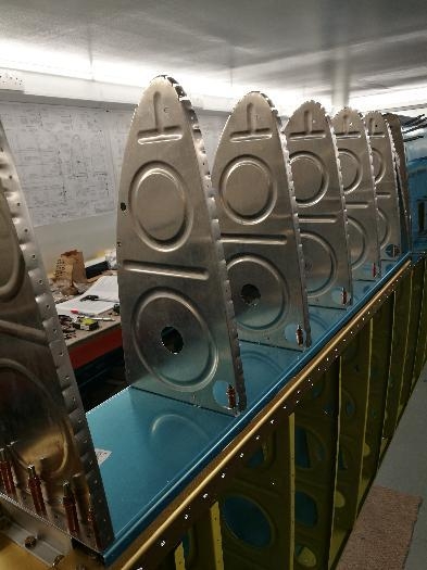

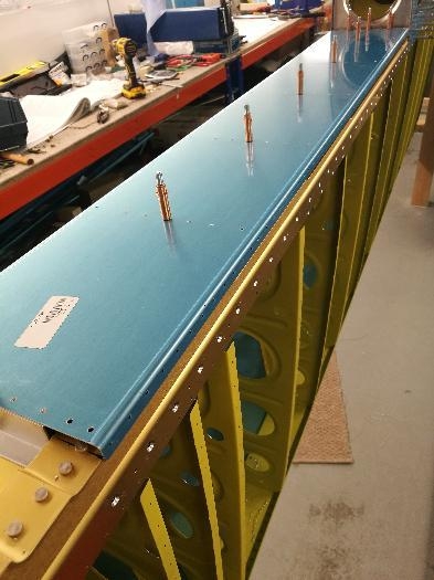

LH Tank.
LH Tank works cont.
16:45
Rivited nut plates to z brackets.
First fit z brackets to spar.
Checked tank skin alignment.
Match drilled tank ribs to rear baffle/z brackets.
Cut tank stiffeners.
Match drilled tank stiffeners.
