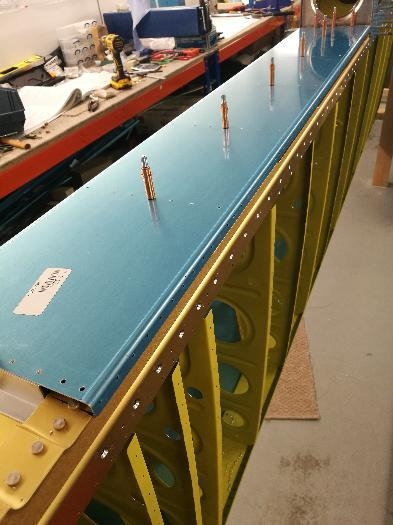

LH Fuel Tank.
LH Fuel tank works.
14:00
Prepared Z Brackets.
Match drilled Brackets to main spar.
Trial fitted LH Tank to rear baffle and wing.
Drilled z brackets for nutplates.
Match drilled rear baffle to z bracket centre holes.
