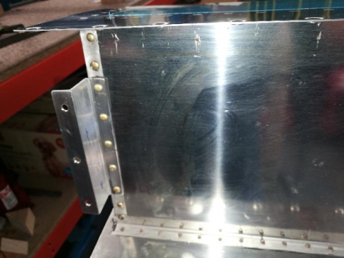

Prepped LH Tank for sealing back baffle plate.
Prepped RH Tank for sealing back baffle plate.
Pro sealed RH Skin to take baffle.
Clecoed all holes on skin to baffle.
Rivited skin to baffle.

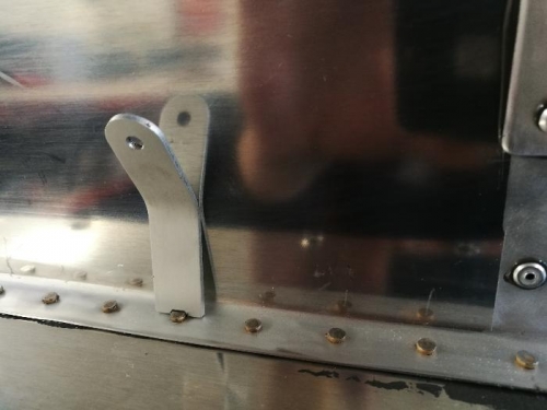

Rivited z brackets to rear of tank.

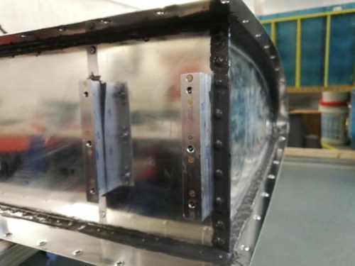

Pro sealed all rivet shop heads in continuous bead.
Touched up any suspect areas with pro seal.
Set aside for curing.
