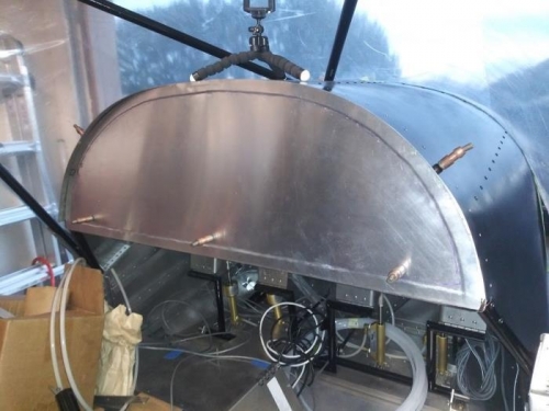

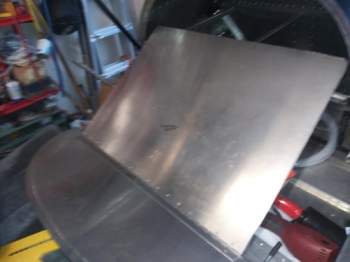

Brief Description:  Dash panel and insterment shelf
Cut the panel and shelf out of .030 6061 T6 sheet with air nibbler
Beveled edges with 3d printed tool that fits on vice grips
attached piano hinge to shelf with a4 rivets on 40 pitch
clecoed panel to piano hinge
more work to come
removeable shelf
removeable shelf
hinged panel
hinged panel
beveled panel
beveled panel
