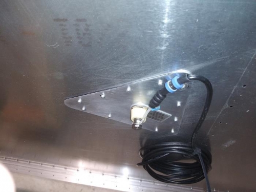

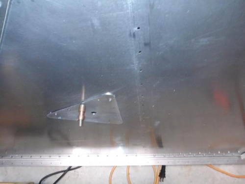

Brief Description:  Installed VHF Com Antenna
Rami VHF Com Antenna installed tonight. This morning I solder the terminal rings on per the instructions, would of preferred crimping but that was what was called out. Added kynar shrink tubing over center conductor and shield. Added a doubler under the skin used 40 pitch on A4 rivets. Coated with coratech. And finaly installed the antenna, Only had one thread left, I wish they had of added another 1/4 to the thread on the antenna.
