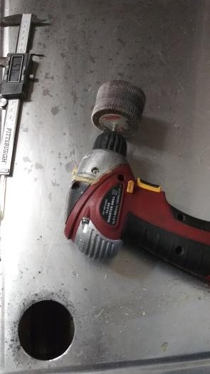

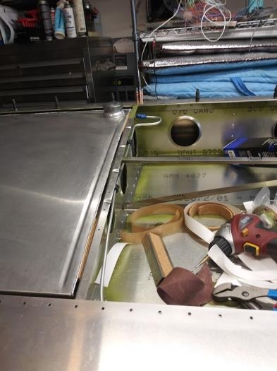

Brief Description:  Cutting hole for Fuel Gauge Sender
added cork to tank aera
Cut hole on top of fule tank for Stewart Warner Fuel Gauge Sending unit wit hfly cuter
set fly cutter to 57mm then open hole up to final 59mm size with sanding flaper wheel
have videos
hole for Stewart Warner Sender
finishing hp hole on topr
Vent line
Vent line
