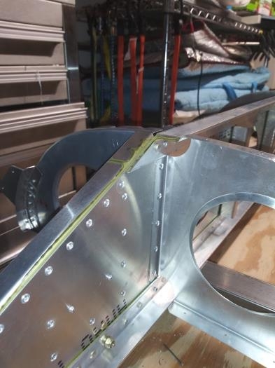

Ataching Wing Ribs to Main spar
got 2 ribs attached, Drilled to #30 then to #20, debured added coratek, and riveted with A5 rivets,
Forgot to first drill the bracket for the aleron mount to #20, will have to do it with it mounted.
Ribs to main spar
