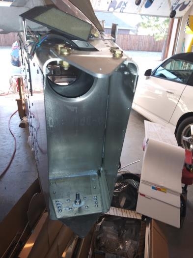

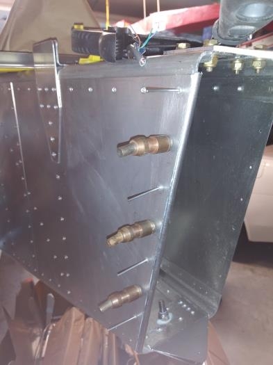

Installed Rudder mounts
Installed lower mounts 75F3-1, 2 and 3 with A5 rivets coated all parts with Coratech and installed I bolt for tie down.
installed 75f2-7 top mount, Used An3-5 bolts insted of the AN3-4 that plans called for. The -4 was to short and no threads ere visbile outof jam nut.
Trimed 75Z1-1 to fit Drilled out to # 30 and debured
installed 75Z1-1 on each side with A4 rivets coted with coratech
uper and lower mouts
