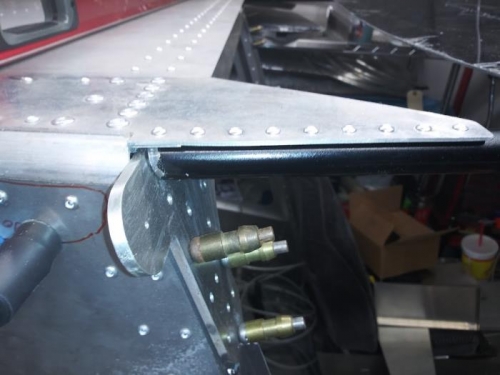

ROUNED Corners of parts, cleaco and match drill to #20 bit, debured and coated with Coratech.

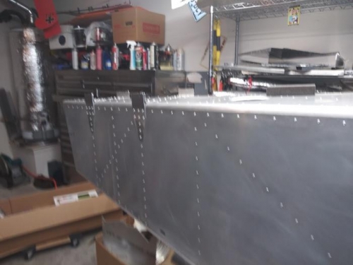

Riveted with A5 rivets. Riveted the last of the top skin with A4 rivets.

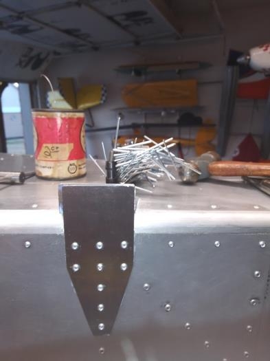

Riveted cabin frame to top doubler with A5 rivets
75F2-6
INSTALLED 75F2-5 75F2-6
