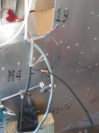

Solderd wires to plug leads and crimped spade to wires for fuel gauge.

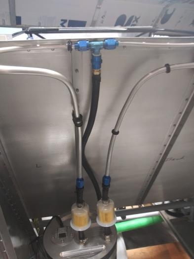

Flared tubing for AN-6 to 5/16 Barbed fitting.
Connected 5/16 fule injection hose from tank to vent line and from tank lines to fule filters and to thank.

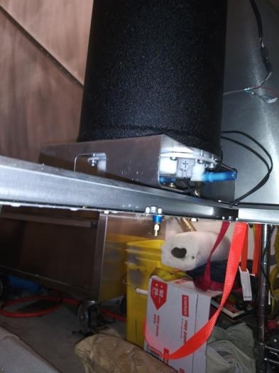

Fitted tubing to fuel drain to bottom of tank
ran fuel lines to tank
