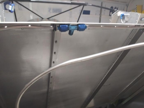

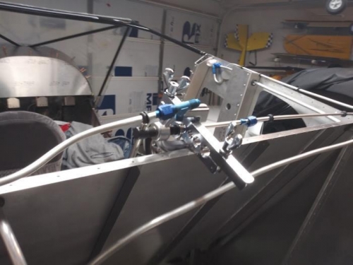

Brief Description:  AN fittings and Tubing for Header Tank
Installed rubber grommets on rignt side
Installd AN nut and Ferrel
Flared tubing with 37 deg flare tool,
Ran 1/4 tubing for Header Tank Vent line with AN fittings
Teed behing baggage compartment.
Need to install Adel clamps.
Vent and Fuel tubing
flareing tubing for Tee
Eent Tee
