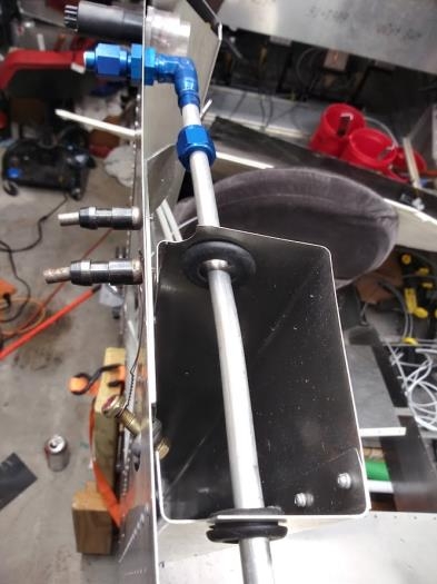

Brief Description:  AN fitting and Fuel line form wings
Installed rubber grommets.
Installd AN nut and Ferrel
Flared tubing with 37 deg flare tool,
Nut and ferrel would not go through grommet..... so cut off flare
installed tubing though grommets installed nut and ferrel and flared while on the plane.
Flare tubing.
Flare tubing.
