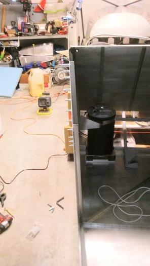

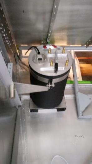

Brief Description:  Header Tank install
Added square tubing to floor mounts for header tank.
Added a L brace to side of fusulage.
Drilled with #40 bit on a 40 pitch
Drilled out with #30 for A4 rivets debured and added coratec to L brace and bracket
Drilled brackect that goes between l brace and header tank with #20 bit for A5 rivets on 30 pitch
Header Tank
Header Tank
L Brackts and
L Brackts and
L Brace at 40 Pitch
L Brace at 40 Pitch
