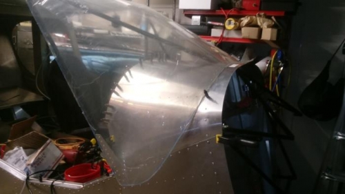

Brief Description:  Glare shield instalation
Match drilled Glare shield 75F16-2

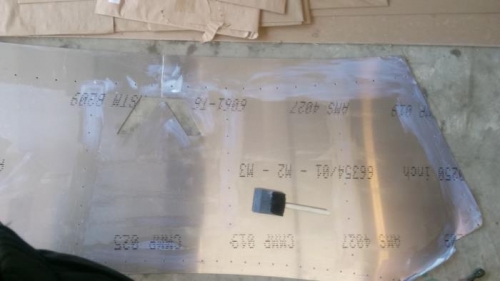

Cut to fit around frame

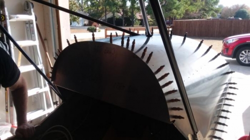

Debured Coated with Cortech and installed with A5 Rivets
Installed insterment panel to get alingment correct.
This was extremly diffucult to get the panel inside the lower sheet metal
it took alot of wiggeling and taping to get it to aline, and was worse after adding corosion protection.
Glare Shield
Glare Shield
Coratech corision protection
Riveted in place
Riveted in place
