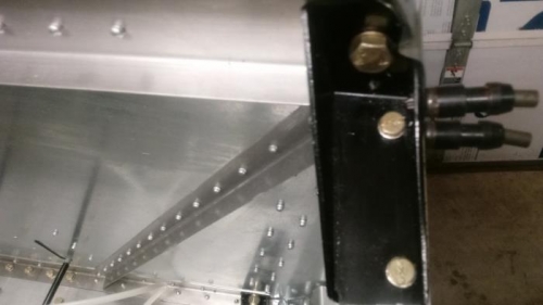

Date:  11-15-2019
Manual Reference:  75-FA-6
Brief Description:  installed internal motor mounts
Installed internal motor mount connecting gustes 75F14-1, 75F14-2, use AN3-5 bolts on top and bottom
Plans called for AN3-4 bolts on the top mount but there were no threads showing past the nut so I replaced with AN3-5
