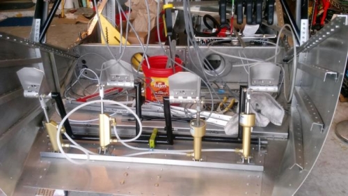

Brief Description:  Brake Lines and master Cylender assembly
Removed Fire wall Lois debured and added Cortech to edges.

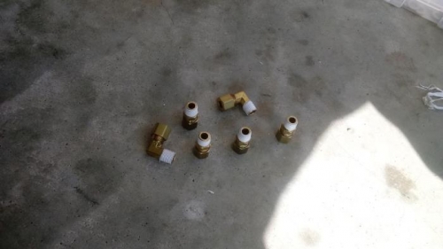

Added Teflon tape to NPT fittings

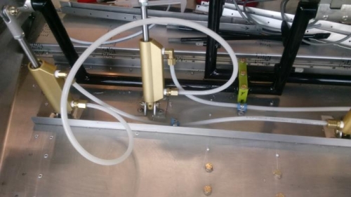

Installed Lines Looped outlet to matain seal
Added adle clamps on hoses and installed carter pins on castel nuts.
Reinstalled Firewall.
NPT fittings
NPT fittings
Installed Lines Looped to matain seal
Added adle clamps on hoses and installed carter pins on Castel nuts
