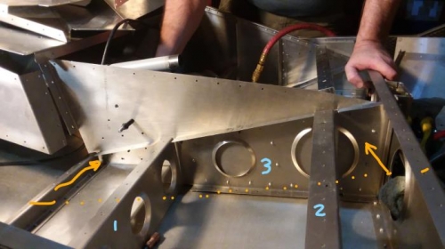

For the sliding seat option part 75F11-2 labled #3 is removed and parts 75ss01-1 labled #2
and parts 75FSS01-2 labled #2 is added.
I found that with a bit of trimging the part #3 it can be moved from its orignal location between the center control to the side of the fuselage to along side the center consol part number 75F11-6
75F11-2 was debured, coted with Cortec and riveted to 75F11-6 with A4 rivets.
This mod increases the longitudinal strekngth of the center section while tying the seat pan to the flool

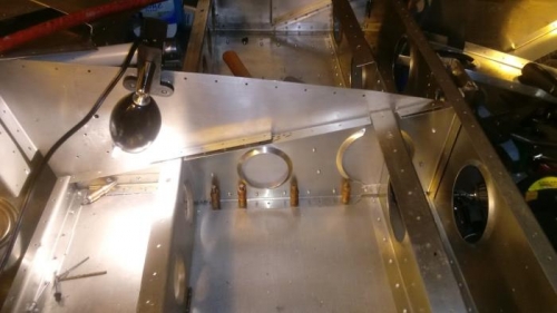

Image 3
Holes drilled with #30 drill bit to attach 75F11-2 to floor pan75-F-7 L angle placed on top of 75F11-2 to keep Corteck from glueing the parts together so Seat Pan can be installed
To be done
Debur floor and lower holes along 75F11-2 L angle installed between 75SS01-1&2 and 75F11-6
Tryingto figure out how to do this as the seat pan has to be installed to alight 75SS01-1&2
