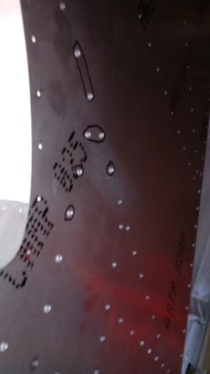

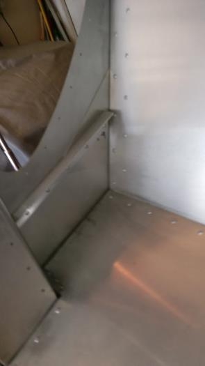

Fusulage Gusset
Found gusset that was left off, drilled out rivets, match drilled the gusset to #20 for A5 rivites, debured and coted with cortec. installed and rivieted with A5 rivets
f75f9-1
gusset
gusset installed.
