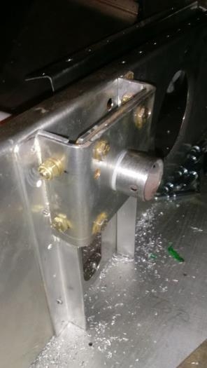

Brief Description:  Torque Tube Front Barring Support
Clamp the Fairlead inside the flanges of the Bearing so the Fairlead is flush at the top. Back drill through the Bearing into the Fairlead with a #40 drill bit and Cleco.
Mark the bolt hole locations . Slide the Bearing on the end of the Torque Tube. Clamp the Bearing to the Torque Tube Bearing Support the Torque Tube so it make contact with the Seat Front Channel.
Expanded holes for AN3-4A Bolts and nutted together. Ground 27 mm hole to match torque tube OD. Had to mout top side bolts with nuts out to give clearance for rudder control cables.
Drilled supports out to #30 holes
Debured and coated with Cortec assembled to frount seat channel with cleco
Bearing and fairlead
Torque tube bearing mount
