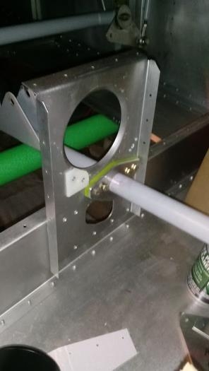

Rear Torque Tube Mount
Inspected all parts and found to be drilled to final size and debured. All parts coated in Cortec.

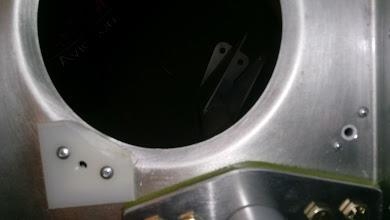

Installed two fairlead nilon bushings on rear torque tube mount. Note, could not find anthing other than the part dimensions in the plans. The only info on this was on Disk 2 of Fusulage part 1 of the Home built help video. Bushing hole drilled to #20 hole for control cables.
Rivieted 75F5-1 Torque Tube Bearing Support to Torque Tube Bearing Channel with A5 Rivets
Rivieted 75F5-1 Torque Tube Bearing Channel side gusset to fusulage each side with A4 rivets
side gusset Rivets
side gusset Rivets
