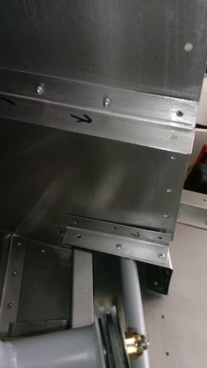

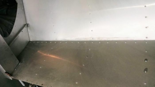

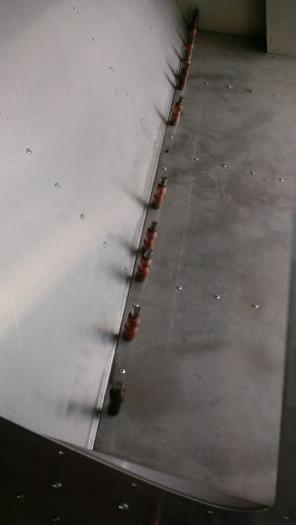

Brief Description:  Riveted Rear Baggage Floor
PN 75f5-3 All holes had been Mached drilled to #30 and debured.
All edges debured
All contacting edges had been coated with Cortec primer and were ready to rivet
Back edge and sides riveted with A4 riviets Found one rivit on the L bracket missing rivet
cleaned rear panel and baggage floor.
