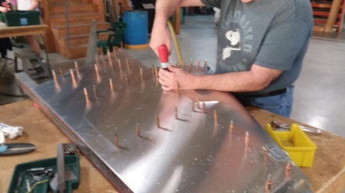

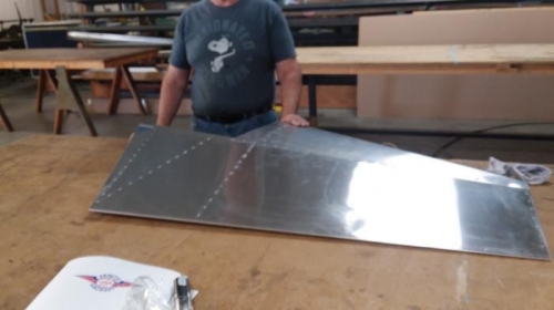

Matched drilled to #30 hole size debured all holes and edges. Applied cortec VCI 373 to mating surfaces. riveted with A4 rivets using Zeinth riveter with machined head.
Rear skin
Rear skin

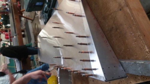

Nose Skin
Nose Skin
