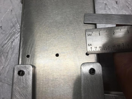

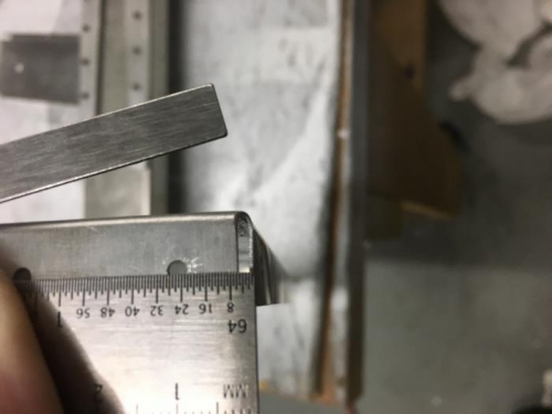

Number of Hours:  0.50
Manual Reference:  SNX-T03
Brief Description:  Troubleshooting
Going back to the plans, the holes in the main spar channel call for 13/32” from the side. The laser cut holes were punched at 21/64” on each side. I checked the ribs and they were correctly cut at 13/32”. I’ll contact Sonex tomorrow. Hopefully I will not have to replace the channel, there are a lot of rivets holding it to the Main Spar Fitting.
