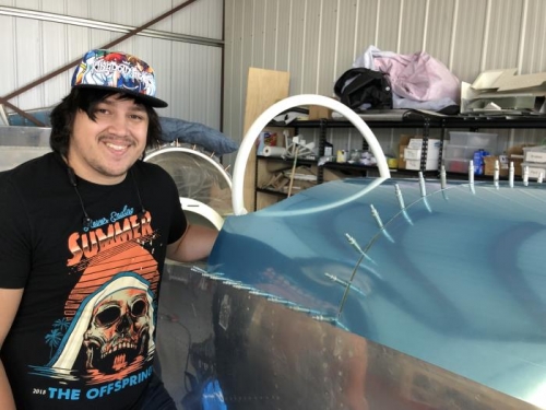

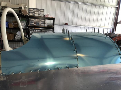

When we opened up the box today we were amazed to find that the kit now has pre-drilled holes for the skin. We quickly removed the original (painted) skin and clecoed up the new one. Amazingly all of the holes matched up - except the last three on the right. But, with a little persuasion we got it to cleco. I am thinking that the fuselage may be just a little wider at that station than it should be. But, buy starting the cleco from the rear and working forward, everthing fits.

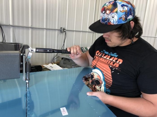

So, instead of 4 days, Cameron knocked it all out in under 2 hours. Basic operations were to ream the hole to size, dimple and debur. We were both very happy.
Dimpling the skin on the bench
Finished product - ready to install - but not for a long time
Perfect alignment of all holes
