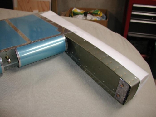

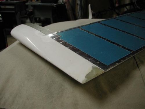

Brief Description:  Right Elevator Tip Work
Positined the tip on the Elevator and match-drilled the holes... was carefule to hold it in position and to put a cleco in place after each hole was drilled. Deburred the holes and dimpled the holes in the Elevator using the hand squeezer. Used the drill stop and machine countersink to countersink the holes in the fiberglass tip. Fasted the counter weights to the counter balance arm and torgued the nuts to 25 inch pounds. Clecoed the tip into place and set the CS4-4 blind rivets. I wasn't planning to fiberglass the joint between the Elevator and the tip, but the way it fits or maybe the lack of fit is making me lean towards filling and fiberglassing the joint and the blind rivets to give it a nicer finish for painting.
