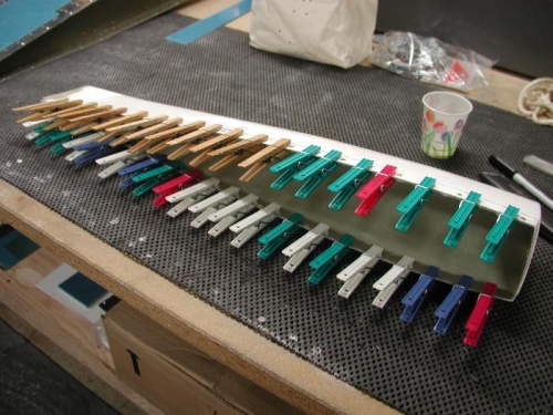

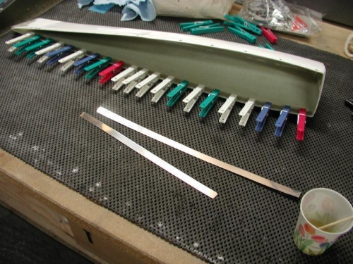

Brief Description:  Elevator Tip Work

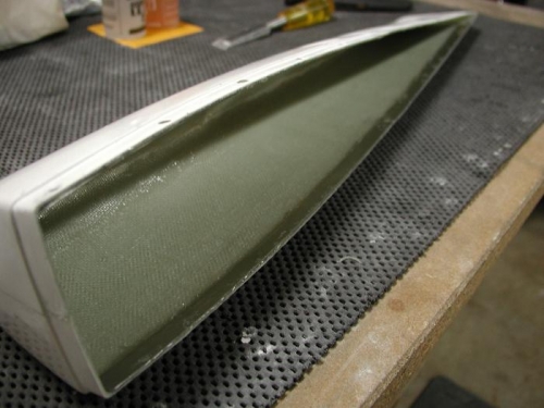

Got back from our vacation trip to Leavenworth, WA and the T-88 glue had arrived via mail while we where away. So, back to work on the right Elevator fiberglass tip. Mixed up the glue and glued the aluminum reinforcement strips inside the fiberglass tip. The glue needs to dry 24 hours before putting the tip on the Elevator to match-drill the holes.
