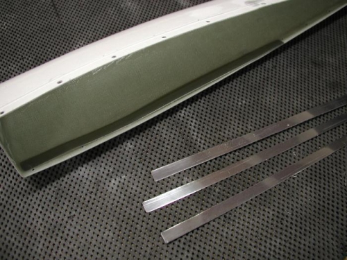

Decided to use 1/2" .025 aluminum strips glued to the inside of the fiberglass tip to reinforce the CS4-4 blind rivets. So I cut four strips from scrap stock supplied by Vans... sanded the edges flat on the belt sander and finished deburring them with the deburring tool. Ordered T-88 structural glue from Aircraft Spruce to glue the strips onto the inside of the fiberglass tips.
