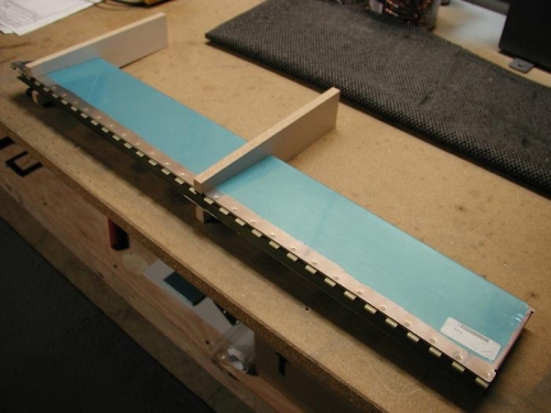

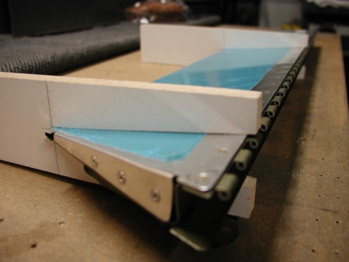

Brief Description:  Trim Tab Completion

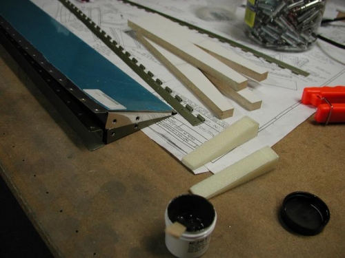

Got the blind rivets from Van's and finished riveting the bottom skin to spar. Glued the two foam ribs into position. Placed the V-clamps into position. Clecoed the top spar to skin to hinge and the inboard and outboard skin closures. Squeezed the spar rivets and set the blind rivets in the end closures. Next step is to positon and drill the other half of the hinge to the Elevator.
