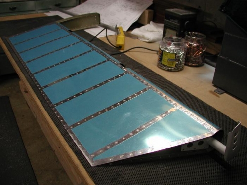

Brief Description:  Right Elevator Trailing Edge Riveting

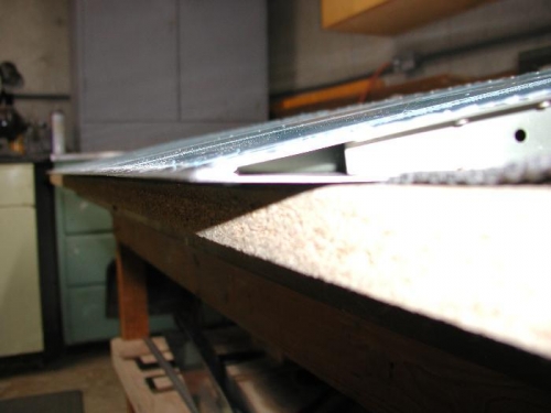

Completed setting the trailing edge rivets, set the rivets on the inboard and outboard ribs and finished filing the trailing edge. I used blind rivets to fasten the skin to the ribs on the rivet closest to the trailing edge for both Elevators due to very narrow access to buck solid rivets. On to the trim tab :-)
