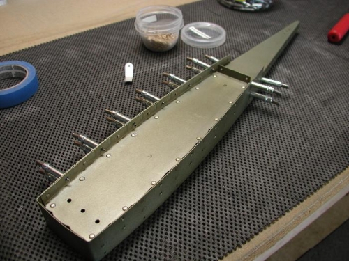

Brief Description:  Priming & Right Elevator Work
Finished deburring the right and left skin edges. Cleaned all the right and left Elevator parts with MEK in preperation for priming. Primed all the parts with Sherwin-Williams P60G wash primer. Began work on the the right Elevator... riveted the two E-910 reimforcement plates and the two nutplates to the spar. Riveted the inboard rib to the spar. Attached the Wd-605 to the spar and rib and match-drilled the holes. Deburred the holes and riveted the Wd-605 to the spar assembly. Riveted the E-903 and E-904 ribs together and then riveted the counter-balance skin to the ribs. Next step is to rivet the stiffeners to the upper Elevator skin.
