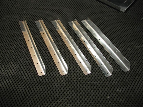

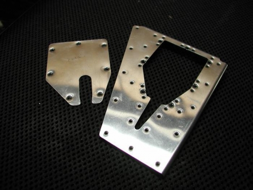

Brief Description:  Elevator Preparation

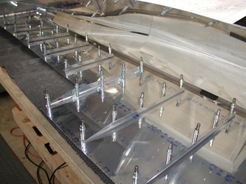

Marked and cut the short stiffeners located forward of the trim tab on the left elevator. Deburred and match-drilled the stiffeners for the left elevator. And match-drilled, deburred and dimpled the E-615PP bracket and cover plate. The elevators are one of the more difficult parts to work on so far due to the fact they are prebent and it is hard to keep them open while working inside. I have a 3 foot balsa block I wedged in the back to help keep the skins open.
