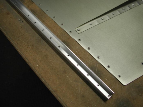

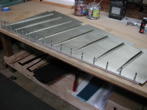

Purchased a 4' piece of aluminum channel to use as a a support when gluing the trailing edge prior to riveting as called out in the plans. I decided to use the channel instead of the angle as I thought it might provide a little more rigidity. Match-drilled the channel to the trailing edge using the right Rudder skin as a guide.
