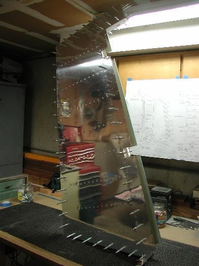

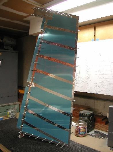

Rudder Skeleton
Completed match-drilling the rudder skeleton and clecoed the skins to the skeleton. The assembly is now ready to have all the #40 holes match-drilled.
