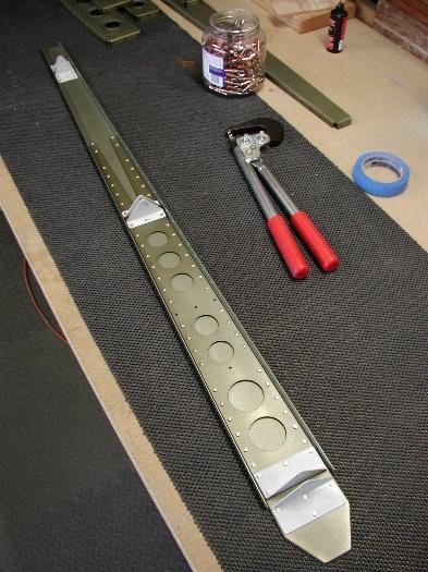

Brief Description:  VS Riveting
Clecoed the VS rear spar parts together and set the flush rivets on the lower portion (see image #1). Finished setting the rest of the rivets on the rear spar being careful not to set rivets in the holes where the three ribs attached to the rear spar. Clecoed the front spar and the ribs together and set the rivets the hold them together.Then clecoed the VS-901 skin to the front spar and rib assembly (see image #3). Set the first 5 rivets on the front spar starting at the intersection of VS-707 and VS-702 working towards the tip of the VS. Called it a day, but am happy to have made significant progress on the VS.
