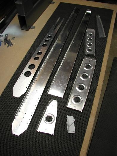

Brief Description:  VS Prepping and Priming
Scuffed all the VS parts including the inside of the VS skin. Cleaned all the parts with lacquer thinner and PPG DX330 Acryli-Clean and then sprayed them with Sherwin Williams P60G2 Wash Primer. The wash primer sprays on easy and dries to touch in minutes. It is dry enough to work with within an hour.
