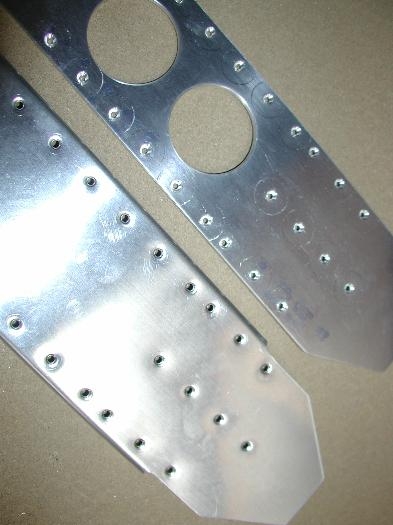

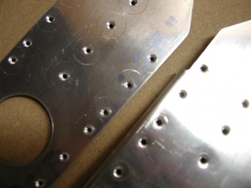

Brief Description:  VS Drilling & Dimpling
Finished match-drilling the VS-901 skin to the sub-assembly. Dissassemble the VS parts and deburred and dimpled as appropriate. I dimpled the lower portion of the rear spar as per the plans and counter-sunk the corresponding holes on the VS spar stiffener to accept the dimples in the rear spar. All the parts are now ready for scuffing and priming.
