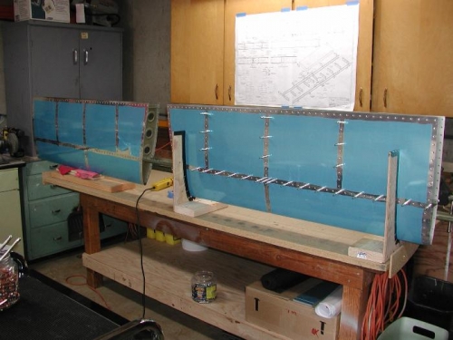

Date:  5-3-2009
Number of Hours:  4.50
Brief Description:  More HS Riveting ...

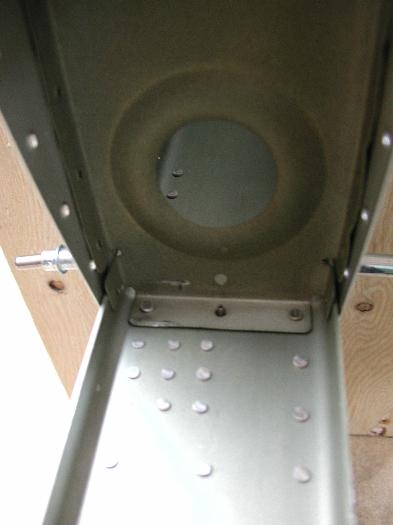

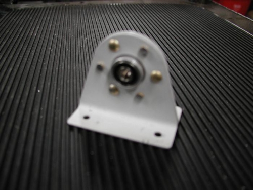

Finished riveting the right HS main ribs and started working on the left HS... same steps as the right HS. Placed two of the three inboard nose rib-to-spar-to-main rib rivets without incident. Amazing! Now I have to get more of the AN470AD4-8 rivets to replace the ones I bent and drilled out on the right side. I'll probably drive down to Van's tomorrow afternoon to pick up the replacement rivets. Also riveted the HS-911 inboard hinge brackets to the VA-146 bearing. Its now ready to bolt on when the HS is completed.
