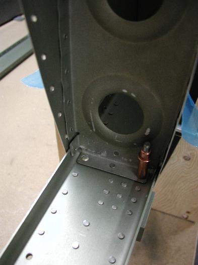

Brief Description:  Riveting Ribs to Spar
Finished installing two of the three inboard HS-904 nose rib to spar to HS-905 main rib rivets. I have one more rivet to complete and am waiting for the single offset rivet set to arrive in the mail from Avery.
Here's another builders hint: put a small piece of masking tape on the head of the rivet set. This will help keep the rivet set on the head of the rivet and also protect the head of the rivet. The tape will need replacing frequently, but it really does help.
