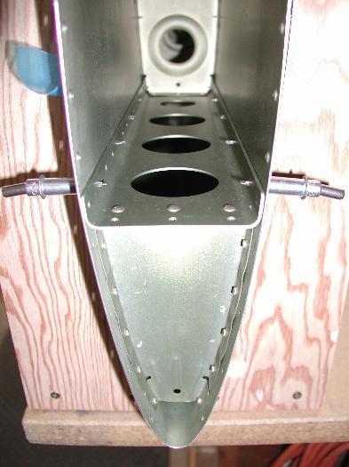

Brief Description:  HS-904 Ribs to Spar
Riveted the two intermediate main ribs that have no associated nose ribs to the from spar and clecoed the spar into the skin. Made the mistake of riveting the outside main rib and had to remove the spar and drill out the three rivets so I could have access to rivet the outboard nose rib to the front spar.
